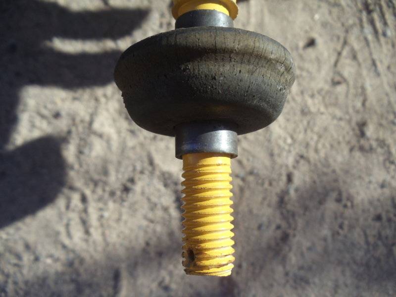

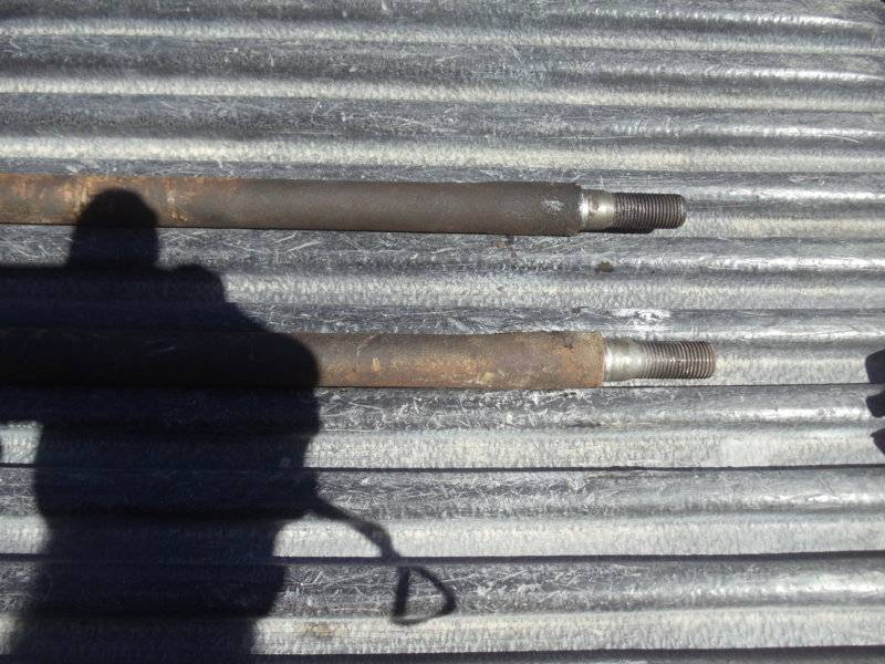

This AM a local shop removed my '72 Satellite front suspension parts for a rebuild. It appears that both strut rods have a very, very slight bend/curve just before one of the threaded ends. I would like to know if they are bent, the shop bent them, or were they manufactured that way? Thank you.

Strut rods will get bent from wheel-Road impacts. Check the area on the subframe where they mount as well, check for cupping.
Well, according to the foto I posted, do they look "bent" or not? The portion I have concern about is just to the left of the threaded portion. Thank you.
If that little tweek I see means they are "bent", what happens tomorrow when we put it back together, alignment problems?
And if/when I replace them later, do other parts need to be removed as well for access? Thank you.
They should be straight BUT when the ends are formed they tend to be somewhat off center. So if you rolled them on a flat surface there should be no bow in the middle but they might still wobble.
So what I see in your photo is, in my opinion, normal from the forming process (and I have four just like them, two of which are original to my car which I've owned since '73 and was never in a collision and two of which are NOS !!)

They are supposed to be straight, but not uncommon for them to be slightly bent. I think some hack alignment shops may have even bent them to get more caster angle?

That looks normal to me. Has to do with the manufacturing process i think, to have enough meat to do the machining.
All the ones i have seen look exactly like that.
Mine looked exactly the same, I ended up replacing with qa1 dynamic adjustable rods

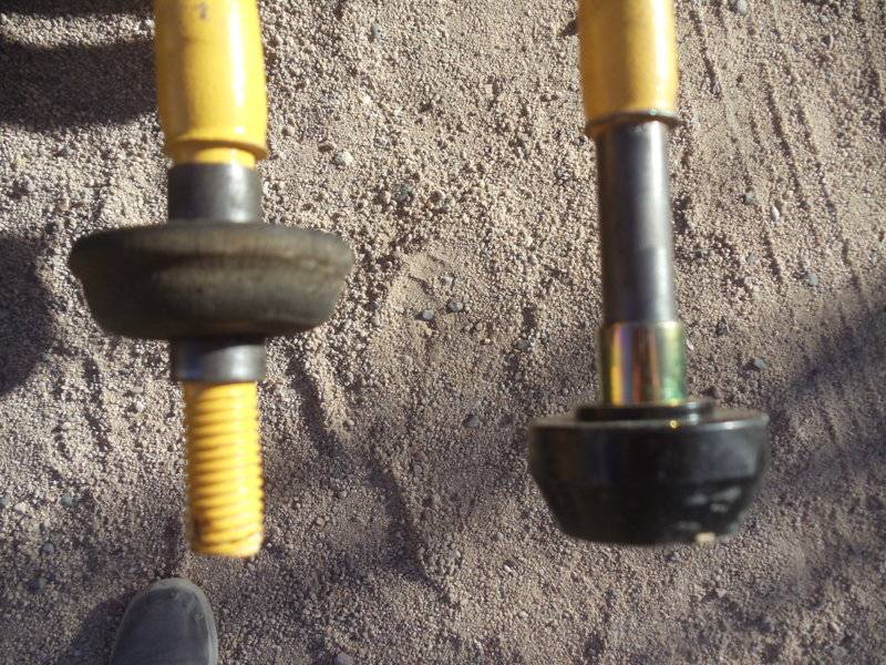

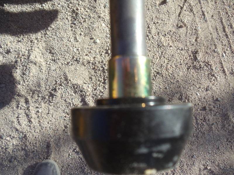

Now I just found out that the PST Poly Bushing metal insert (inside diameter) is too small and will not slide onto my strut rod end! What is going on here? This is a '72 Satellite.

Now that I returned home to measure with dial calipers:
Old factory metal insert inside diameter .0638"
PST metal poly metal insert inside diameter .0628"
strut rod outside diameter .063"
close but no cigar?

Update on problem: PST tech called to say said metal insert may run a little small to compensate for the strut rod possibly being a little worn. Maybe.
The first option given was to reuse the old sleeve/insert. My old inserts are worn pretty thin. I would rather not do that.
Then I was told some installers open the new PST insert up a little so it fits/slides on the strut rod. I was not told the insert was meant to be an interference fit.
On my way back to the shop doing the install now. Looks like we will just have to wing-it in some kind of "Mexican style" to make it fit. Buyer Beware.
