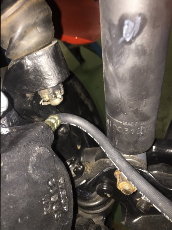

Thanks, the bleeder is on top but the hose points towards the front of the car. The service manual kinda shows the bleeder up but the hose pointing back. The only I see this possible is if the calipers were towards the front of spindle. I took the car apart over 2 years ago.
They fit just fine until I tried to connect the hose

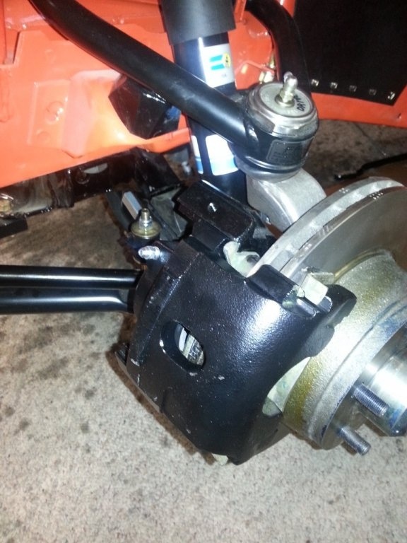

I'd wait for somebody known more than I but is it a kit or a stock setup? Seen kits with front caliper mounting. Is it possible you have the right spindle on the left and left on right. Don't go ripping in to it until you get more answers. If it's a kit call them and email pictures to them.
Edit: Looked on My Mopar at a 73 service manual looks like they mount to the rear. Something doesn't look right, duh.
2nd edit: looks like hose should go to back of car. If you put the caliper in first picture ( left side on the right side) would the hose face to back of car and would the bleeder be at the highest point?

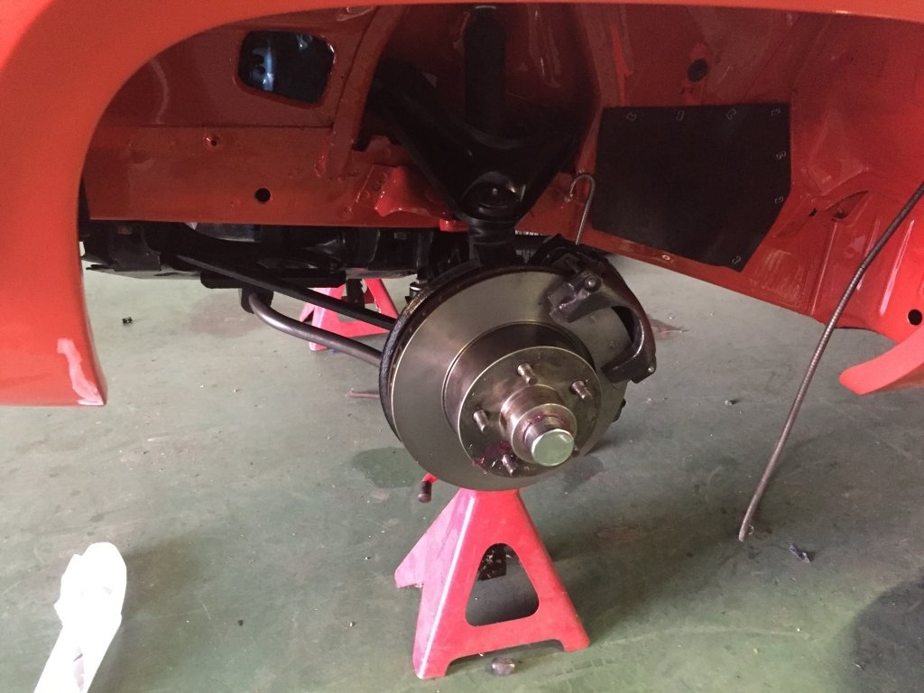

I went to see my friend Mr. Peabody and his pet boy Sherman and they gave me a ride in their Wayback machine. Well, way back in June 2014 I took this picture when I first found the rust in my frame rails and it shows the calipers were in front of the spindles. Gotta love this car restoration hobby, now I get the pleasure of disassembling my front end and putting it back the correct way. Life is good.
