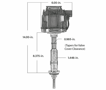

I was ordering the Mancini HEI distributor and I came across this line.
This HEI Distributor will not clear Mopar Performance aluminum valve covers.
There are certain models where this HEI is too large and will not fit: 62 Plymouth, 67 GTX, 68 Coronet or 69 Charger.
I have a stock 383. How could it be different from a '68 or '70? This part was just under $350 complete. Is there another one that will work for similar money????
Here's the whole ad.
Big Block Mopar HEI Distributors
Thanks.

I would be more worried about it fitting under your hood. It says it is 14'' tall from manifold flange to top of cap.
I just measured my stock 383 distributor and it is 8'' tall so this HEI is 6'' taller than stock.

I did'nt realize they were so tall either till I saw the schematic. That cap would be level with the top of a stock air cleaner.
