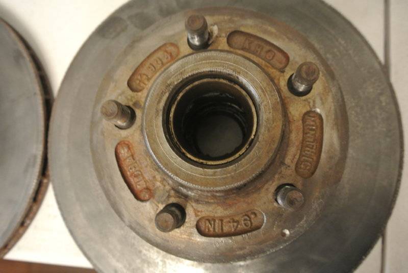

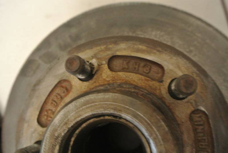

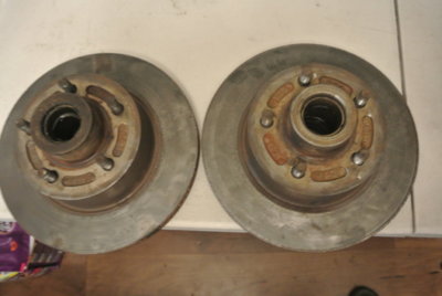

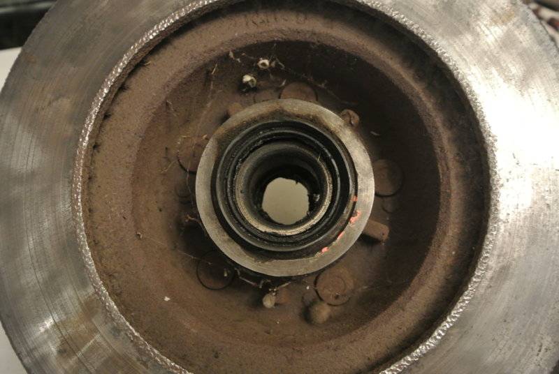

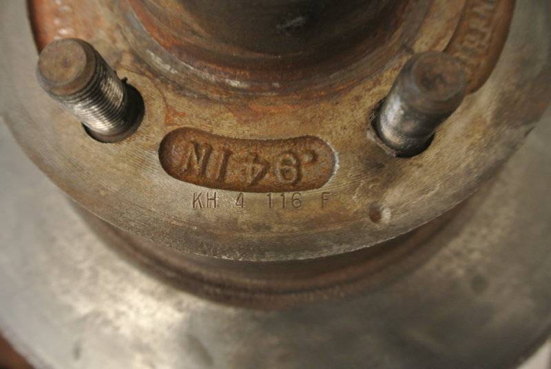

Are these Kelsey Hayes B body rotors
bb66cuda
9:34 PM
Jun 3, 2013
8
0
San Jose, CA
I have a set of Kelsey Hayes one piece rotors that came off of a 1971 Satellite. I am wondering if they are correct for the car, since it looks like most factory rotors are the 2 piece design. These have KH markings and reinforcement ribs on the back similar to the Bendix design. They are 1.00" thick.
On my 71 Satellite and 71 Charger the rotors were 1 piece design with integrated hub. Looks right to me.

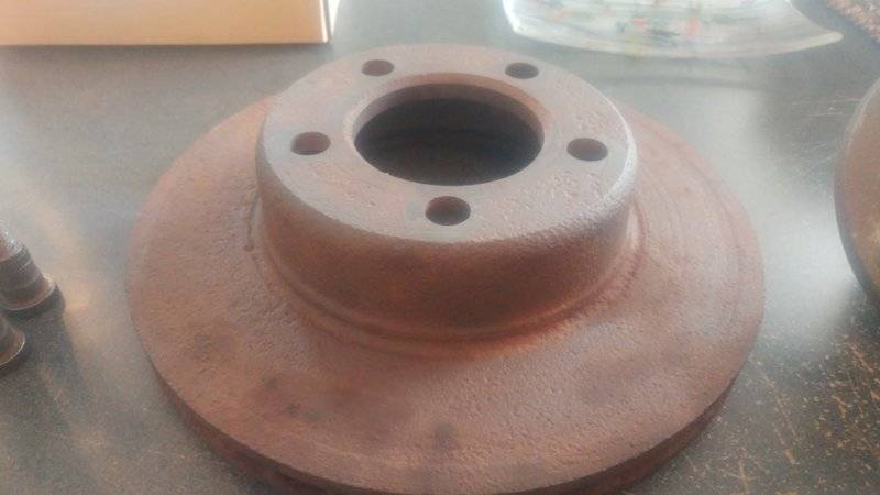

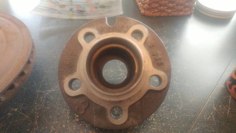

10.98" dia and min of .94 with the 4.5 bolt patter is the KH design for the 70-72 B and E. I am sure at some point one piece had to be the replacement for the 2 piece since that became the industry standard by 73. I can't be 100% sure about the date code, but looks like a 4 116 which may be 74 part as OEM replacement. Originals where 2 piece.
HOWEVER ------- 1970 through 1972 ------- is FAR< FAR different, than the 1966 - 1969...............
