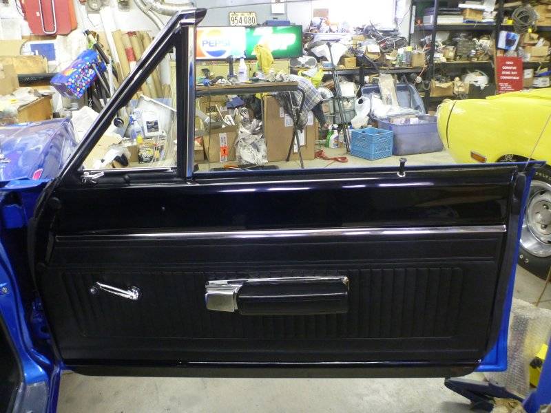

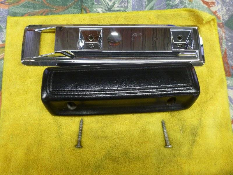

Fronts also are the only ones with provisions for the door handle so they are a bit longer in that respect.
