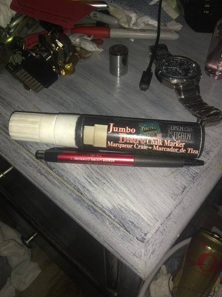

Get one of these big white chalk markers at Walmart to write your number and dial in on your window.
Get one of these big white chalk markers at Walmart to write your number and dial in on your window.View attachment 1293469
Thanks, padam.
I will be sure to pick one of these up.
It's going to be a few weeks yet, as there
is no glass installed in the cab yet.
I've checked out NHRA's website. Seems
straight forward enough.

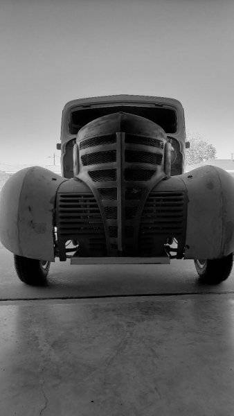

I've been to Roswells' track on a number
of occasions, but only as a spectator.
Looking forward to seeing my son nail
the throttle at the starting line.
(old photo)

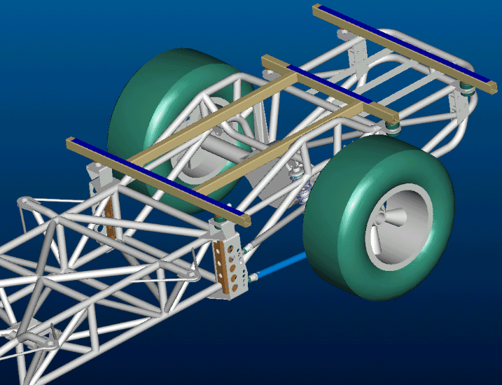

The tube frame was jigged and welded
in our shop on a layout table, so it does
not have a certification, but is not just
thrown together. A stress analysis was
generated on the computer model and
all potential failure points were addressed.
I hope the frame is not a roadblock.
They will come to your shop and cert it for you. Cost is slight.
