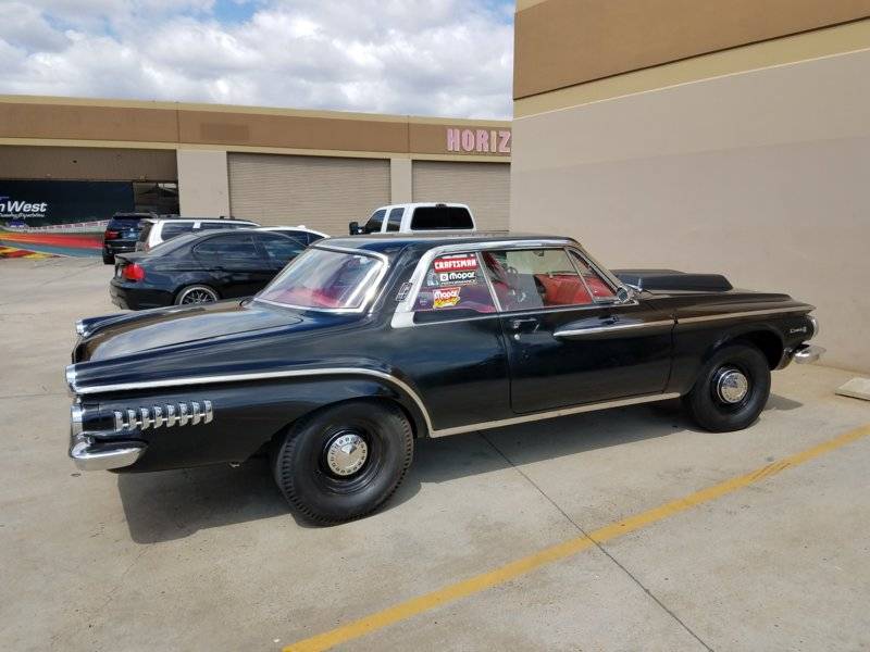

was wondering how much torque and power my stock axels can handle I have 65 rear end in my 62 dart would like to take it to the track but don't wanna snap axles . going to use 9.5 slicks with 4:30s on a prepped track?
