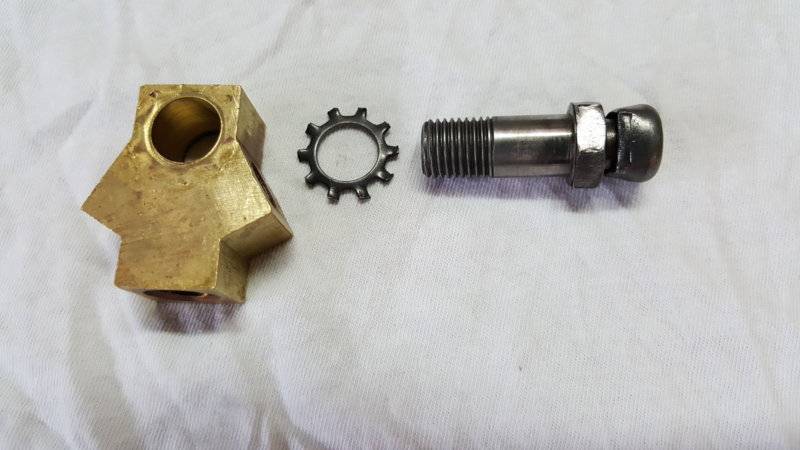

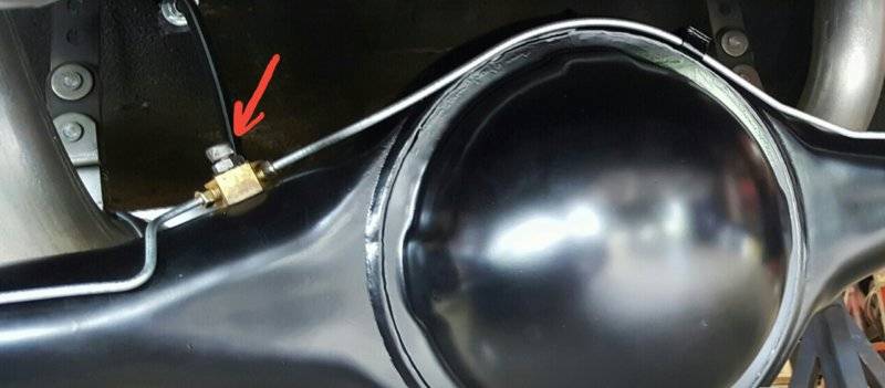

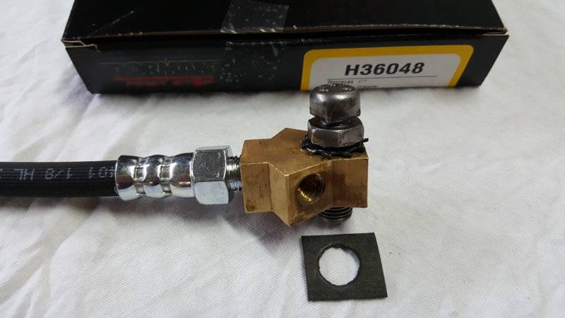

Make sure the vent is open. Could build up pressure in the housing on a long trip and push lube out the seals.
Just screw it out of the "T" block

Krysler: well I have seen that vent, but didn't think it is for that purpose but I will remove it and clean it.
Housing vent...hint...unless it's nasty, and just needs to be cleaned, to 'clear' the vent, just twist the cap on the top. That usually clears it.
miller: I did not see your post else I would twist the cap.
What I did is: I removed the vent bolt, pressure fuel cleaned it, pressure air blowed it, the cap is spring loaded open, and is lke a check valve, dont let air in just out.
Filled the deferential with grade 90 oil, drove the car for 27 miles, still leaking at both sides.
