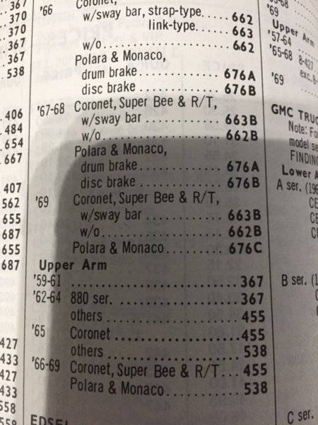

Have a guy interested in my upper and lower control arms. Question is will they work on his C body. didnt want to give him bad info. He was interested in the entire K member but again wasnt sure a 66 B K would work in his C body. If anyone knows let me know thanks.
This is from one of my older Hollander manuals.... they list different interchange numbers ....
Thanks for the info.. I just didn't want to tell the guy they would work and then him get pissed that I sold him something that was wrong.
Tell him to do his own research ! I would never buy something on someone s word !
"C" Bodies use very different Lower Ball Joints (much bigger than the B & E)
And very different upper and lower control arm bushings....
Bottom Line --- very different....
