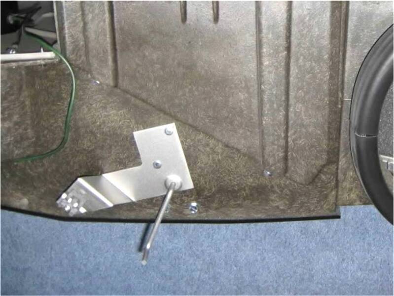

this is a view of the blend door bracket for a 1968-1969 (1970 is the same as this but with a different heater core)
here is one for 1967
this way you can see the difference on the orientation of the rod in relation to the cable bracket. you will have the push pull action but the result will be opposite relative to the control (cool versus warm).

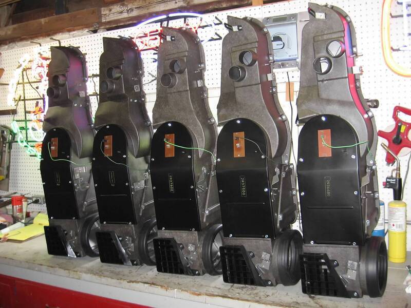

there is also a small difference how the box is molded by the defroster tubes but that won't cause any issues.
the 2 from the left which are 1966 and 1967, you see a difference in the box from the other 3 which are 1968, 1969 and the far right 1970.

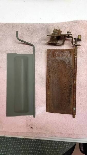

it is not just the bracket. you have to look at the arm and which direction it goes in relation to the box. the 1966 and 1967 arm goes towards the middle of the box and everything later 91968-1970), the arm extends out over the front cover of the box. one on the left is 1968-1970 one on the right is for 1966.
