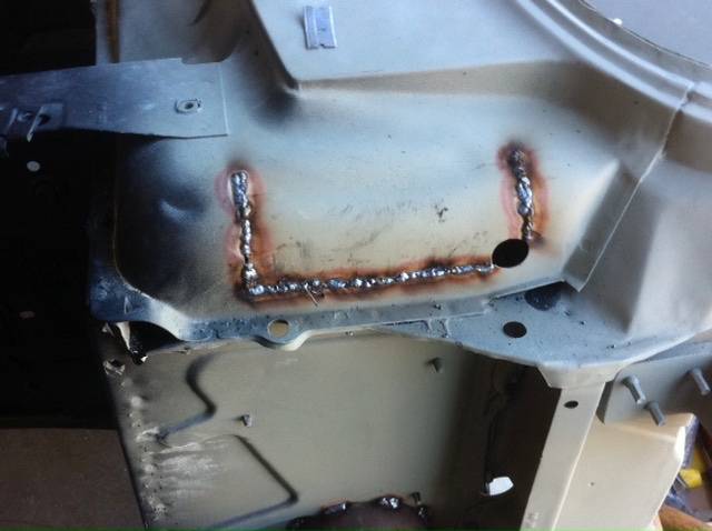

What I've done is on the end where the fender will cover the cowl I've cut open flaps which allowed me access to clean the lowest areas of the cowl, I had access to access any rust issues & to completely seal the metal to prevent future problems... The picture is of my Falcon but the same thing can be done on Mopars...
the other option is to remove the upper cowl completely......if you suspect the lower is rusted badly or on it's way out
