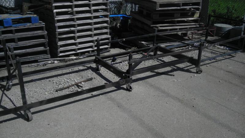

so does anyone use these jigs,homemade or not can you show pictures of yours, anything would be helpful
Here is a picture of mine. I'm trying to get rid of it, to bad your not closer. IMAG0614.jpg
