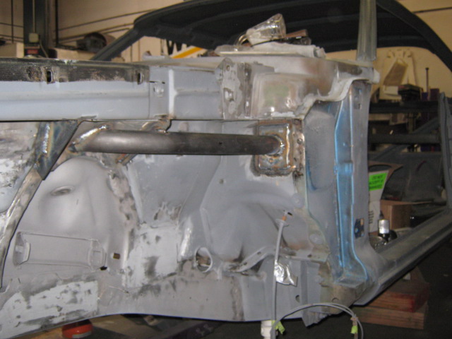

I installed the inner fender component of XV's stiffening system on Thursday.
The lower radiator piece was welded in when we had the whole front clip off the car. It really made a difference just with the car sitting on the rotisserie!

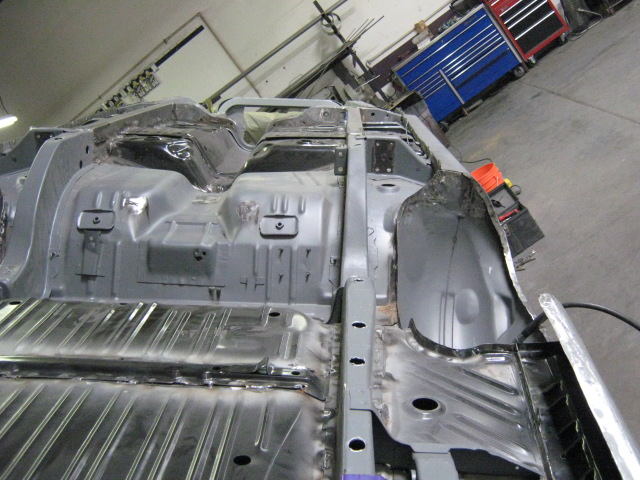

Next step will be the frame connectors but I cannot flip the car on the rotisserie until I get the wheel houses and 1/4's re-installed. The entire car was too "flexible" in it's mid section when we raised the rotisserie to try to flip it.
