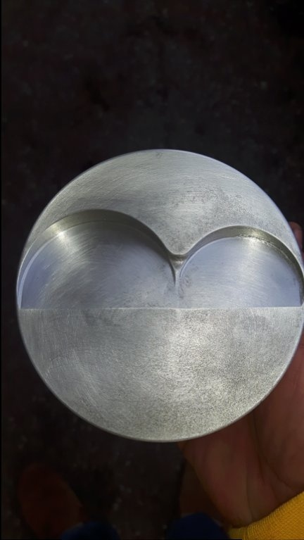

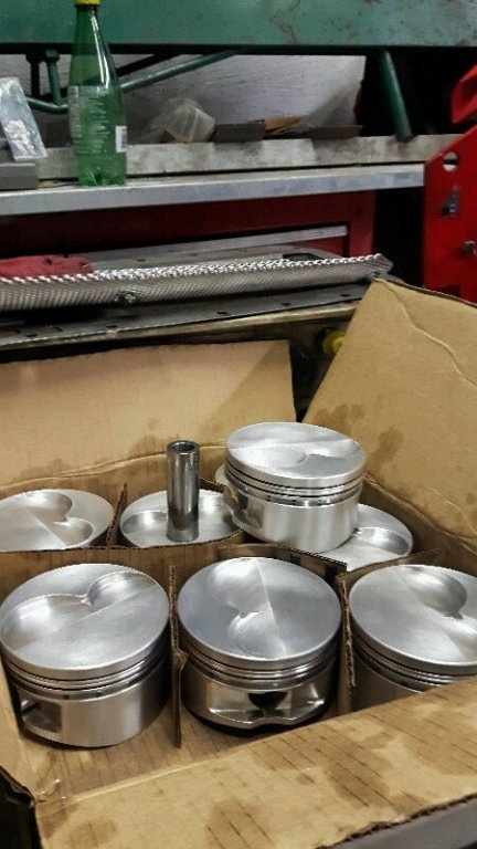

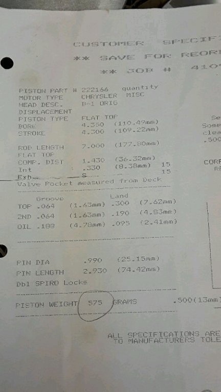

A buddy of mine gave me a set of j.e b1 440 pistons. He sold all his drag racing stuff but had these left over. And owed me some money... Will and indy head work with these pistons?.. he said the valve relief was different but he wasnt sure by how much.. or can they be fly cut?

The valve centerline on a B1 head is moved toward the centerline of the bore. Indy heads 440-1 and lower are in the stock location. It really depends on the camshaft you want to use. Normally they need to be re-notched.

Depends on which head the pistons were designed for. The B1 BS has stock location and angles. As noted the B1 Originals are relocated. As long as there is sufficient material in the piston, the notches can be re-cut. Mock up is the only way to know for sure.
I think what fbs63 is saying is "Yes, you can use those pistons if you have B1 heads OR if you're running a mild cam where the piston valve reliefs don't really matter"
These are the slugs
indy 440-1 heads have a 15 degree angle and 572-13 have a 13 degree angle.
B1 pistons wont work with either of these heads. Not sure if this helps.

Those look like very generous reliefs. The b1 head has a large valve. A conventional head with a smaller valve might work as is. Milling is always an option.
Later '80's I built a low deck 452 with original style B1 pistons. Didn't have finances for the B1's, so ran 906's & 915's with 2.14/1.81 and a 650 ish [email protected] cam. The valve pockets on the B1's are large diameter & deep. Don't recall the angle being a problem, but....
