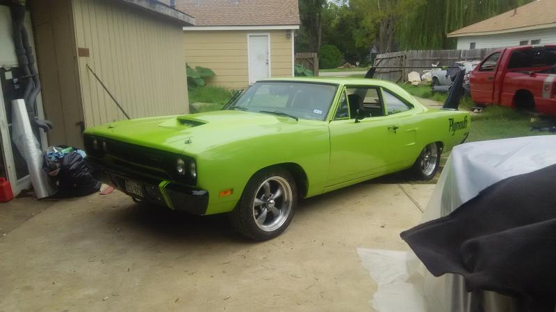

What's up folks. Been wanting to join for a while. I am a huge mopar enthusiast. Just got my project up and going and now I'm driving it from Houston tx to Gatlinburg the on the 16th of this month. Anybody going to the pigeon forge rod run?

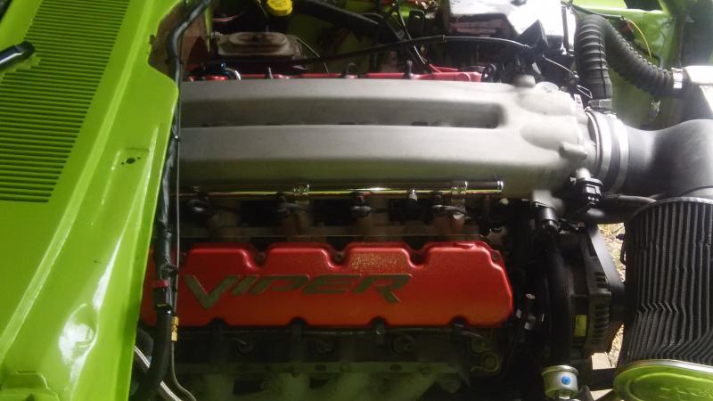

Looks like you have a beauty of a RR. I see you have a Viper motor. What are the specs and details on that puppy. You're in a great place on FBBO. The best place for Mopars on the net. Welcome!
Very cool ,I see a wing are you going to put a nose cone on it?
Cool car, did you do all the install yourself? I am in the process of doing a Gen 3 viper into a 70 RR too at the moment. Lots of work and modifications.
Yes I did the swap myself. I started with a 04 srt10 ram. I put the motor,tranny,steering column, pedals, gauge cluster, every wire from the truck, Dana 60 rear end (had it narrowed), 4.10 gears. The car also has a ridetech 4link, stock sub frame, tubular upper control arms, hotchicis strut rods, qa1 shocks, added sway bar. I cut the firewall out along with the tranny tunnel. This swap was pretty straight forward. The hardest part was putting in the steering column and pedals. The car never ran better and gets over 20 mpg.
Actually the hardest part was getting the nerve to cut the car up. Gotta go down before you can come up
