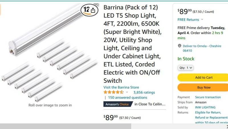

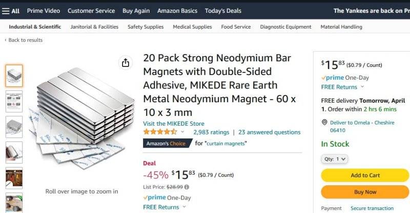

4' LED bar lights with 3" L X 1/2" W X 3/32" super magnets. To attach magnets LED aluminum housing JB Weld epoxy them.

That's exactly what I used on my lifts though had some Gorilla tape laying around so used that along with some hooked magnets to keep the cords from dangling. Easy to move when using the lifts and can pull them down for under car light as well. Did have to modify the plug in cable lengths to accommodate lifting/lowering without having to pull it all off and unplug.

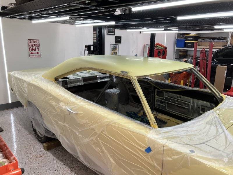

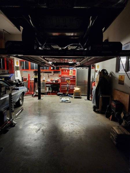

I used four LED shop lights from Home depot they link together and were cheap. Used stickey backed velcro to attach them under the runways. Here are some before and after photos. They each have a on off switch. So you can turn on only what you need.
