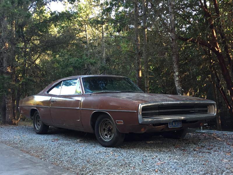

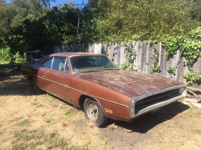

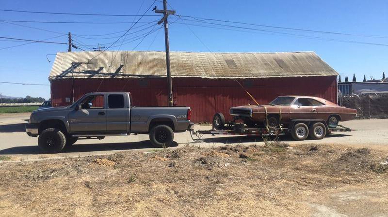

    I introduced myself here in the welcome section a couple weeks ago but I think it's time for a build thread. I've rebuilt motorcycle engines and done a few engine and transmission swaps on some late 60's cadillacs and 80's chevys but this is my first mopar I've ever owned. So I figured it would be a cool idea to document my progress for everyone to check out. Long story short I winched this 1970 charger onto a trailer for $2300 a couple weeks ago. It runs and drives (sort of, I'll address this issue later). I just ordered a 4 wheel disc brake conversion from The Right Stuff today because the brakes SUCK! This is a non-numbers matching car so I don't feel obligated to restore it to it's original condition... but it will be restored tastefully nonetheless. I plan on doing as much as possible myself with the exception of the rust repair and some bodywork (I suck at welding). This car has already turned a lot of heads even on the trailer and some of my friends have told me some pretty crazy stories about it... apparently it's famous. I welcome any and all feedback you guys have as this is my first mopar. I'm a GM guy but this is and has always been my dream car.
    Here's a couple pictures:
    Here's the car as it was found:

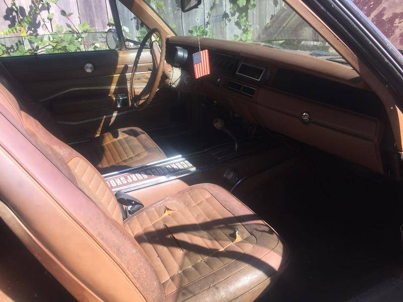

    The interior is much worse than it looks. A lot of critters made their home in this car sadly.
    Victory day!
    Freshly parked:
    Not a bad start!

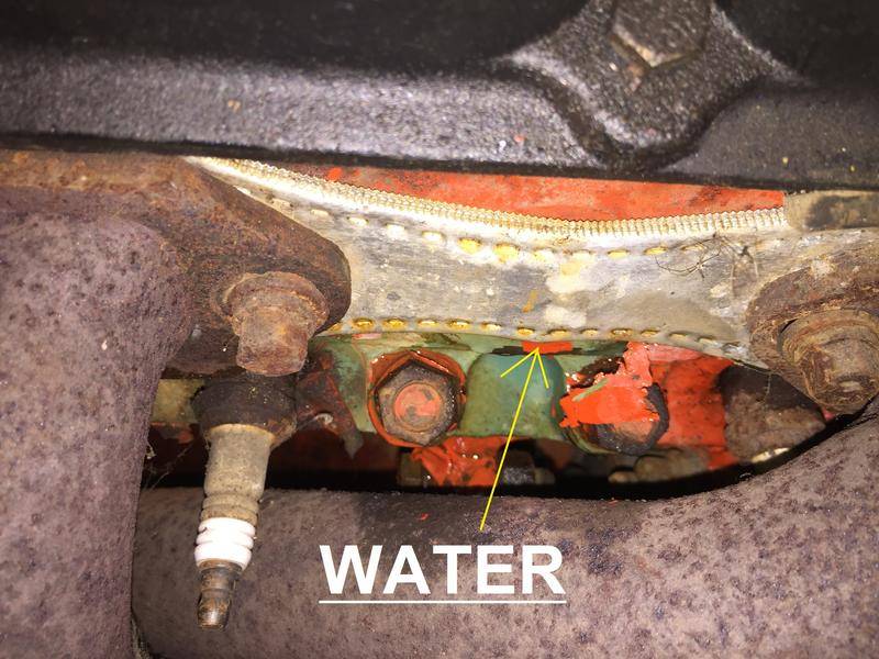

                  So I noticed that the coolant was low (I wasn't able to see any in the radiator) So I filled it up, All of a sudden water starts pouring out the passenger side of the motor... I couldn't tell where it was coming from so I let it dry and then slowly poured some water in the radiator. Water is coming from behind (not above!) the exhaust manifold gasket, is there a freeze plug or something behind there? The cylinder on the right is at the front of the motor.

                  The studs go into the water jacket. Are the studs loose, or wet?

                  Not that I can see. I hit them with some penetrating oil, I'll take them off when I get back from work on Tuesday.

                  there are two freeze plugs on each head behind the manifolds/headers right where your arrow is.
