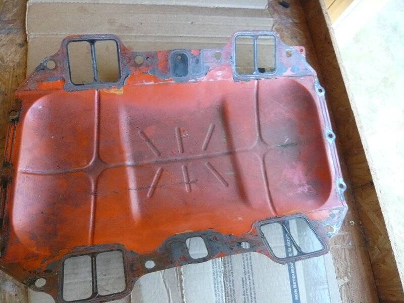

So I did a dry run with the old valley pan and intake and was able to get all 4 end bolts in. this is the old valley pan why is one side blocked off?
Never seen just one side blocked off. Usually those ports are blocked off to keep the exhaust heat from coming up and heating the intake...
View attachment 945051 So I did a dry run with the old valley pan and intake and was able to get all 4 end bolts in. this is the old valley pan why is one side blocked off?
That looks like crud / carbon blocking the heat hole on that one side.
If your running a oem style choke out of the choke well you will want those open.
If not then get the pan they are blocked on.
Set your old intake on your new pan after you have the end bars snug and see what you get.
