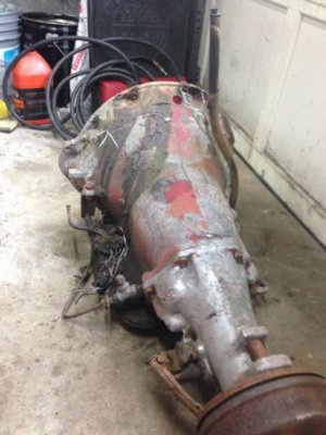

I just removed a 904 from my 74 Duster and I have that exact piece at the rear of the tranny that you have. I've put in a 727 and it doesn't have it. I looked in several books and there is no mention of that piece or even a picture of it on any trans. How about rotating tires front to rear to see if the vibration is now in the front. Do you drive car on a regular basis? Flat spots in tires happen from cars sitting for a period of time. Some tires are worse than others with flat spot problems.
