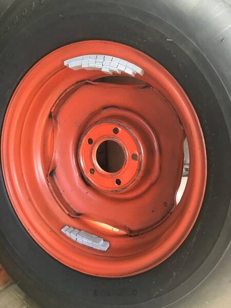

How are ya'll balancing you're fancy new 'red line' tires?
I just purchased a new pair and mounted them on 6in rims and this is what they gave me..?!
This after I brought it home and turned the tire on the rim 90 degrees. Then had them balance it again.
My other wheel is a little better but nearly as bad.
Before this, I tried 10oz of anti-freeze, but it had a shimmy at exactly 45mph through 50mph.
Wasn't real smooth at high speeds over 80mph either.
What do you guys think?
I have less than 2 ounces on any wheel and these old (1978) cast wheels had always been a bugger to balance. All balance weights on the back side of the wheel to boot this time. When I had Michelin radials on a couple wheels had a good 8 ounces of stick ons on them so the Goodyear redlines are actually moulded better or my guy got better at balancing after 20 years, because he did both sets of tires some 19 years apart!

I had the same issue, broke it down and spun the wheel and found it was the problem.
I think it's either a)time for different rims or b)time for a different balancing company.
AH.. now there's a picture I'm sorry but is the guy fired yet, or are they trying to give you a hint that they'd rather mount the tire AND balance it.
Weights directly opposite of each other is conclusive proof that the guy doing the balancing doesn't know what the heck he is doing! But that doesnt mean that there isnt a problem with the wheel or tire.
Edit: goodyear repops, or firestone? From where? Get pictures to send them if you need to return them.
  1. Make sure the wheel is straight.
  2. male sure the tire is good-maybe return them
  3. Find a different balance guy.
Already #3 is a big problem! But something else is wrong with wheel or tire.
you don’t need trick equipment this is basic tire balancing, Find the problem!

Did you see what you are doing? Weights on exact opposite sides of the wheel. :BangHead::BangHead:
If you feel the tire is going to take too much weight do what chtampa suggested and spin the tire on the rim a half turn. Oh I see someone else is doing the balancing. Yes he needs to be fired! What a dweeb!!!!!!!
could be #1 and #2 also.
I see #3 as the biggest problem.
I've never seen that kind of weight on a rim before. Is this a joke?
My advice is to find another tire shop and not a chain store. Use a shop that's been in business for a long time and only does tires.
I bet you if you mount that wheel on your car and drive it over 25 mph it will shake the glove box door open. That is if the weights don't catch on the caliper or fly off. What a joke!

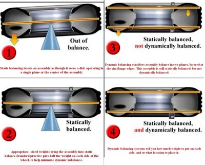

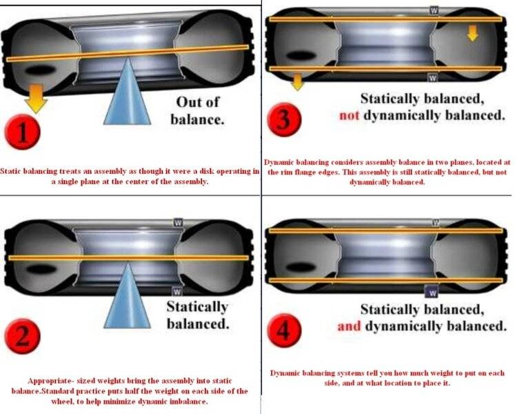

Problem . To properly balance a tire, the weights must be on opposite sides of the wheel. This is called dynamic balancing. The wheel will want to do 2 things when spinning.
#1 Static imbalance, the wheel wants to hop opposite the heavy end of the tire/wheel.
#2 Dynamic imbalance, the wheel wants to wobble due to side imbalance.

Stick on weights with a steel rim. Clearly they have no idea what they are doing....:mad:
