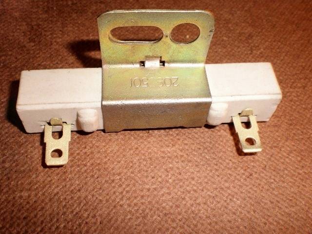

Hey guys. Currently I have this # on my car. Looking to get a backup in case mine fails. Was wondering if this one will also work but think it won't as I have an electronic ignition.
Thanks! I've read that if you have a points dist then you need one but if you have an electronic one that a ballast isn't really needed.
It'll work.

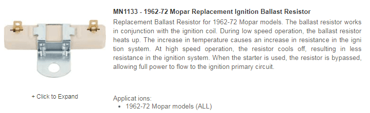

Anyone know where I can get a new one. Been looking online & can't seem to find the exact one.
Thanks! How did you determine that is the correct replacement so I can learn from this.
IQUOTE="The Rebel, post: 910749986, member: 25415"]Thanks! How did you determine that is the correct replacement so I can learn from this.[/QUOTE]
If it is two terminal they all work,this is what you should have if you want to be 100% correct

Thanks Guys, I really appreciate it! I have electronic. So the only difference is that some have 4 terminals & some have 2. So long as I have 2 the shape dosen't mater?
Shape has nothing to do with function. Keep the resistance around 1.2

No, what I'm saying is you will get variation in resistance from part to part

I didn't counter as you were wrong,I just posted a picture of what is correct if it mattered and what will work,shame on me,I'm done !
