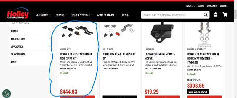

The 5.7 Hemi swap is interesting though. I'd retain the stock K member and suspension. I'd use the 6.4 exhaust manifolds that a buddy gave me.
The engine mount brackets and transmission crossmember from Holley....

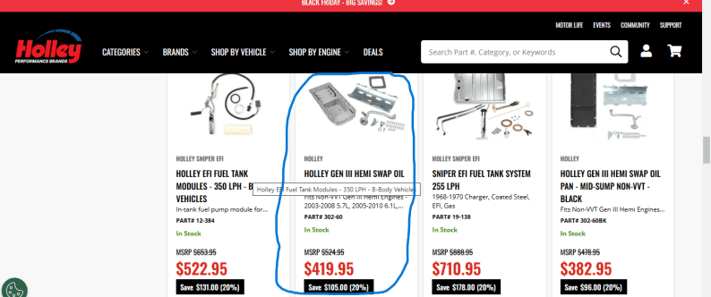

The 5.7 I have is still in my 2007 truck and is still running great even at 407,000 miles. Of course, it will need to be rebuilt so a longer stroke crank kit would be great. Still, it is a truck engine so the oil pan is wrong,

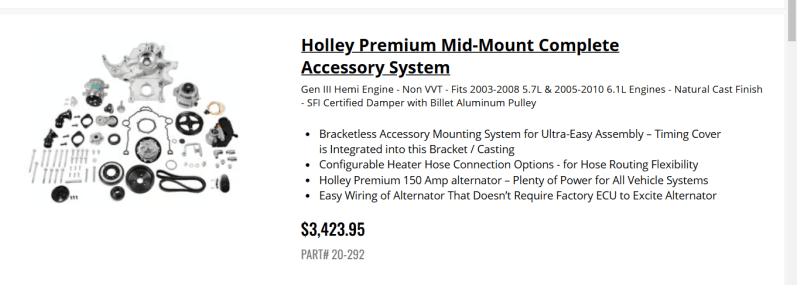

and so is the front end accessory drive...add in the costs for those:
That alone makes it a deal breaker. NO way I'd pay $3400 + for all of this stuff. I'm at $4300 just to get the engine in place and I still don't have a computer to run it or a fuel system to feed it and the engine internals have not been touched. No wonder people go BIG when they do this swap....They must figure that if they're spending $6000 before ever touching the inside of the engine, they might as well go all the way and use a new crate engine.

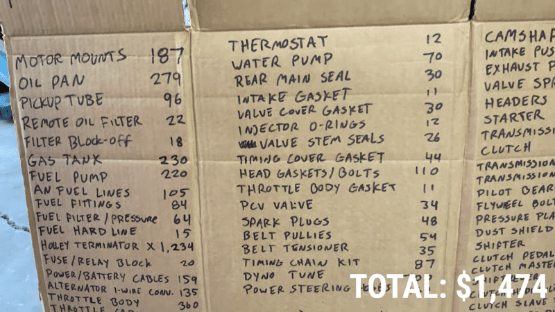

Next he added up stuff directly related to the engine:
He did have "Dyno Tune" in the $1474 number, something that may not be necessary.
All of this is just to install a regasketed engine, not a new or rebuilt one.
