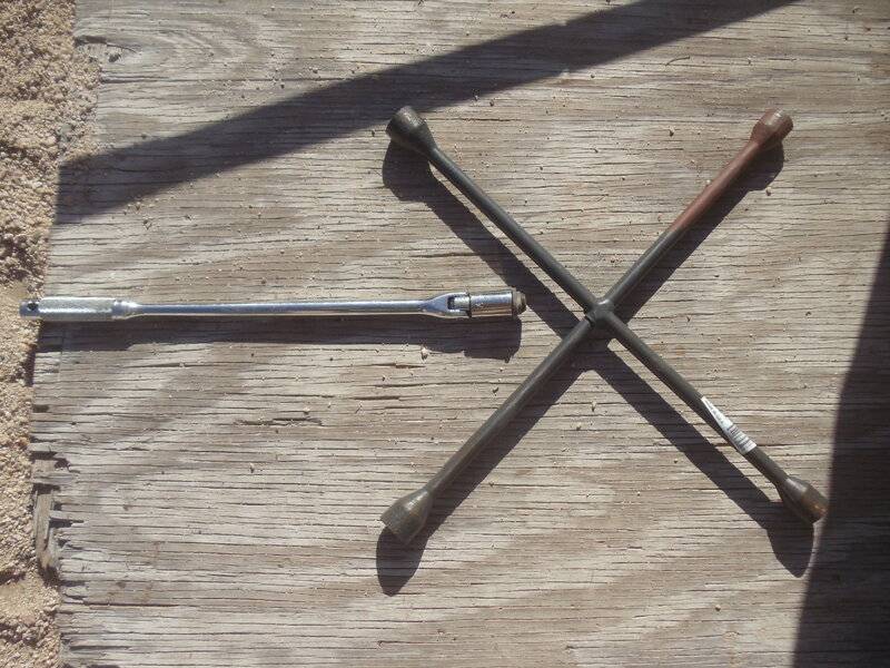

I won't know for sure until tomorrow morning, but I believe I strained my lower back. One front tire on the '96 Dakota had 10 pounds less air than the others so I pulled it off at home. Instead of using the wimpy factory lug wrench, I brought out my extra large star wrench.
I could just barely remove the theft-proof nut with the special key. Then I struggled like hell to break loose the first regular lug nut. The second regular lug nut would not budge, but my back was about to snap in half. Forget this, I brought out my Craftsman 1/2" breaker bar and six-sided 3/4" socket. Not much better, I could feel my back straining as I successfully removed the remainder of the lug nuts. No way an average female could have changed this tire. And with the provided factory lug wrench, I may have failed as well.

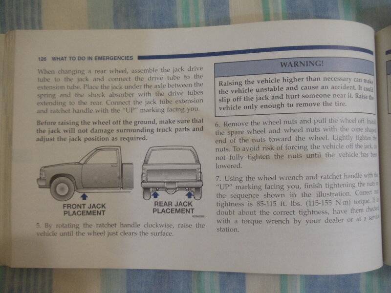

My owner's manual specifies tire lug torque specs at 85-115 ft. lbs. That seems like an extreme range for such a critical item. Anyhow, I recently purchased a four-tire set of new Michelin tires at a local chain tire store. Don't remember if the tires have been rotated on their premises for the first time or if the tires still remain as initially installed. Regardless, I hate to see tire "tech's" using the same impact wrench to remove/install tires on all customer vehicles. Ought to be a law (there are laws about tire pressures). My poor aching back.

I changed many tires on my Viper when I was racing the road courses in the southeast. I always torqued the wheels to 100 ft.lbs. That is not extreme and as hard as you described to get off. Sounds they laid on it hard with the impact. The tire shop I use now uses the torque sticks. I was told the color marks indicate the torque.

You should let your weight loosen the lugs instead of jackin your back! This is why you stand and bounce on the end of a breaker bar so that doesn't happen, or am I the only person in the world that thinks outside the box on making a job easier than it has to be?
I've always stepped on the lug wrench, but when the idiot with an impact over does it even jumping up & down on the lug wrench can fail..
Back in January I was in Austin working at a facility, my rental blew the right rear tire... I attempted to change it & was literally jumping on the lug wrench... 250# on a about 16" long bar.... It wouldn't budge... Called the rental car company... They send a tow truck, he broke out his big breaker bar & eventually he was jumping on that 24" bar.... He was bigger than me so 280+... In the end the rental SUV went away on the tow truck & I got another car... Wasted about 2.5 hrs of my time...
