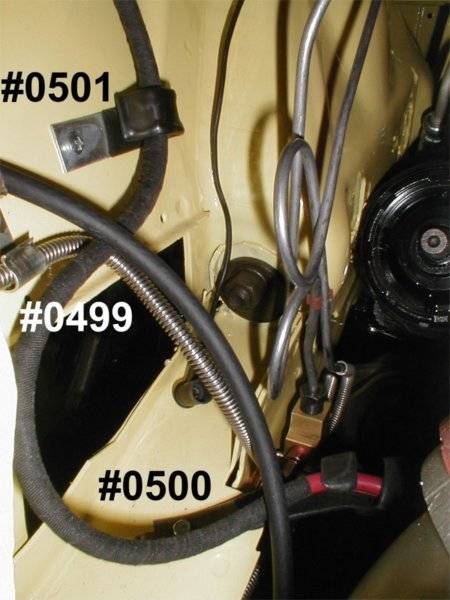

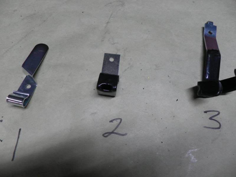

'67 charger auto. trans. does anyone have picture of where these 3 brackets go in engine bay?
I am confused to where they are located. also , is there any bracket that holds the neutral safety switch wire going from switch up to firewall?
thank you.
1. routes the speedo cable and clips on the brake line
2. positive battery cable
3. positive battery cable
The safety switch wire has a clip that attaches with a bell housing bolt
Brewers has one it’s listed for the reverse light on a 4 speed but is the same for the auto
