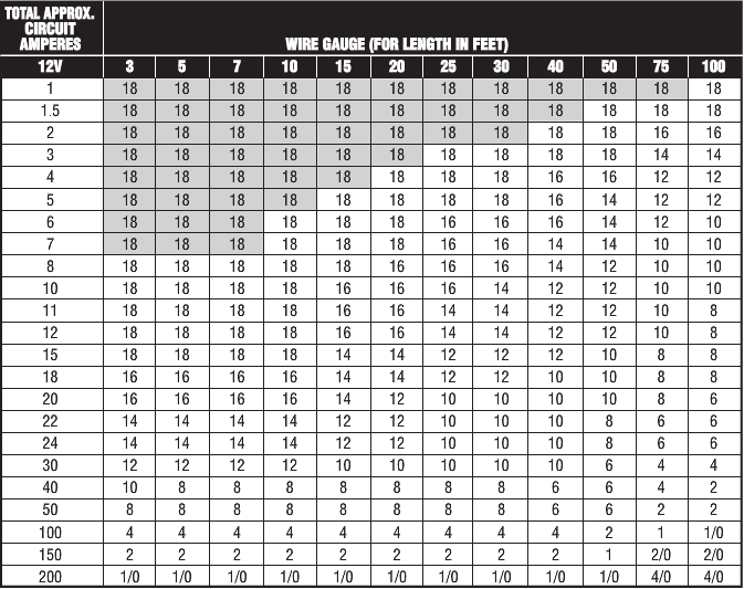

Battery cable must be sized to the needs of your electrical system, too small of a cable will cause excess heat & too long will have a voltage drop..
