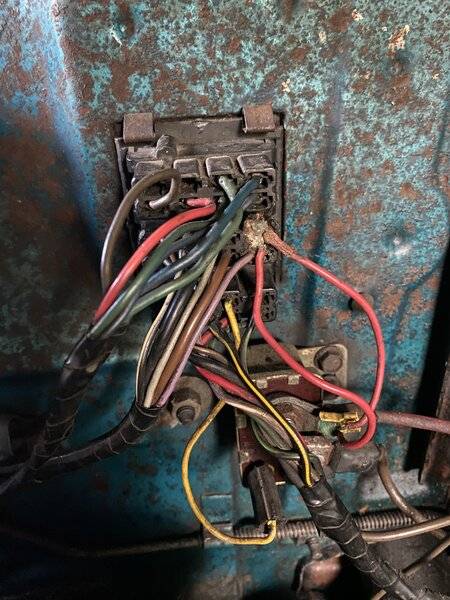

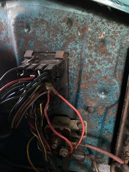

Also seems like a problem..

No doubt. That mess needs to be fixed first. Probably good that the car doesn't run right now. That would be my first priority. Check and service all the wiring in the car. Otherwise you will constantly have problems.
You might consider replacing the harnesses. They cost money but are the heart of your cars systems. And they are obviously in need of repairs. Over 50 years old and not much maintenance has been done. The insulation gets brittle and cracks causing shorts. Other wires have been added improperly...
Pics of your bulkhead connector look like a meltdown ready to happen. If it was my car, I would be ordering a new engine and dash harness at the minimun.
The middle connector is the worst, do you know the name of the connector or a kit which i can replace? Or a whole harness for under the hood
Go to your welcome post I listed a few parts suppliers and links to them. Year one carries and exact replacement harness of very good quality and have volume discounts.
