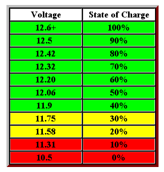

Isn't a fully charged battery 12.6v equaling 2.2v per cell?
Rsnger,
Yes, 12v is a nomimal value. The true measure of the bsttery' s state of charge is to measure the specific gravity of the electrolyte, measured with a hydrometer. Typically, 1.260 - 1.270 spgr (corrected for temperature) is considered fully charged. The individual cell volrage will be ~ 2.2 volts or 13.2 volts total. But with the advent of sealed batteries its impossible to measure either specific gravity or voltages of individual cells. As the battery is discharged, the specific gravity will decrease from 1.260/1.270 to 1.100 or less. Charging the battery with 14.0/14.5 volts will reverse the condition and restore the specific gravity value.
