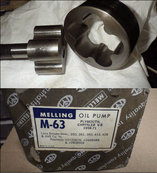

Gerotor set from a 40 year old pump I have...…...

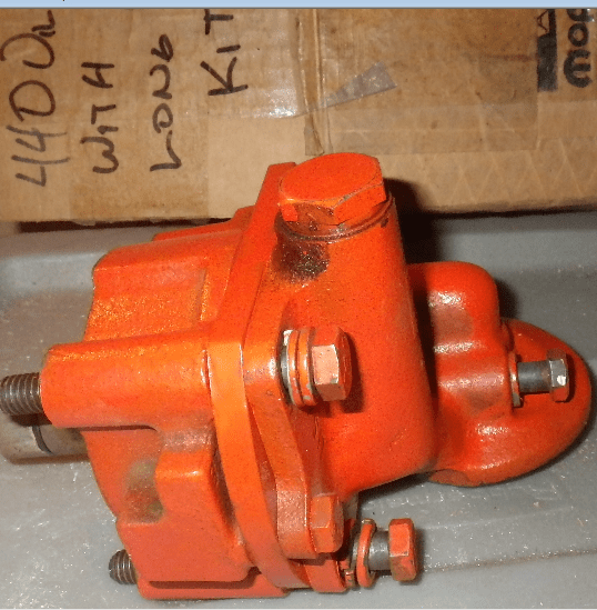

hey used to offer an oil pump spacer kit that had a 1/4" spacer and longer rotors
Lol, just happen to have one of those...….
