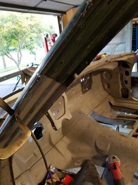

It’s not so much that I want a convertible but was wondering what way would be easier. I understand that it’s more than cutting off the roof and adding a motor and soft top. It needs work in many places. After the mechanical work I am going after the roof so I am starting to plan that effort out.
I totally agree with all this...WAY too much to change over. Believe it or not, it doesn't seem all that hard (at least on TV) to cut/replace the roof on a hardtop. I mean, it's not "easy" & the big deal is getting everything trimmed & lined up perfectly before cutting/welding, but it can be done. PLUS, a roof should be reasonably easy to find since that part is rarely replaced.
What's bad on yours? Does it just need some patches? Is it rusted dead center so you could just put in an aftermarket sunroof? Could you find & graft in a factory sunroof from a Cordoba or something? I know I'm shooting from the hip here...just thinking.
What does your roof look like now?
It's been done. A hardtop to a convertible.
I'm in agreement with MN, fixing your roof is way easier and cheaper than creating a convertible. If the inner roof structure is good, the skin is easy to replace. Even if the roof rails are rotted (like mine were) AMD makes replacements. Keep searching for a parts car and grab what you need.
