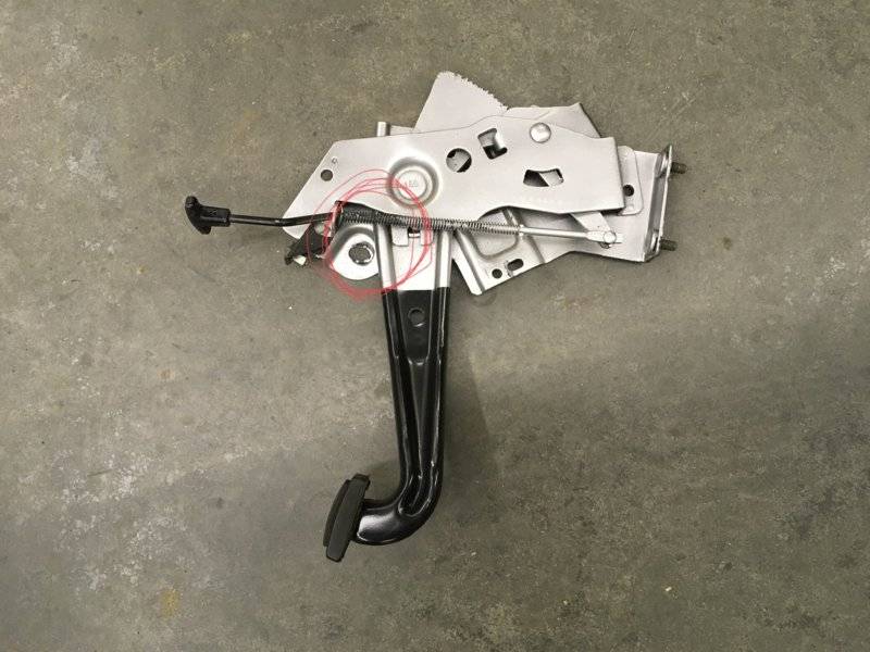

I am trying to take my parking brake off 67 gtx. Is there a bolt inside that mounts the mechanism to the a pillar? I can't seem to break it loose.
Thanks a bunch. Now, I can't seem to locate it. I have removed the inner fender wall nuts and detached the switch. Will detach the cable. Is it located close to the dash. I see a 5/16 bolt but it appears to for the dash brace. Any photo or help appreciated.
The bolt is hole is circled gotta push the pedal down a bit to see it.
Thanks, my set up was so tight that the lever didn't expose the bolt. Got it now.
