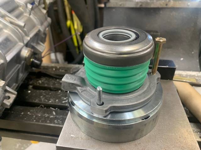

Thanks for the reply. The thing that sways me from going with a hydraulic throwout bearing is if there is an issue with the bearing assembly (leaking), it's a lot of work to change. A slave cylinder is a lot easier to service. What Is the difference in clutch performance between the two that you have noticed?
The feel of the hydraulic unit is very much like a newer car. The stock system of rods & levers and stiffer pressure plates is okay but after driving mine with the hydraulic setup, I see no reason to use the old stuff anymore. I had a 4 speed in a Duster that worked fine but I like the hydraulic stuff better.
If a throwout bearing fails, you're pulling the transmission whether you have hydraulic or traditional style levers and rods. The hydraulic bearing idea has been around for quite awhile, it isn't something that just came out yesterday.
One important concern I have is clutch pedal pressure. While at 70 years young I’m still in decent shape and plan to drive this car for a long time yet, I’d be looking for something “leg” friendly if possible.
Hence the reason to buy a hydraulic clutch.... Dramatically less pedal effort... The slave cylinder/throw out bearing combo has been used since the late eighties with very few issues.... Don't cheap out, buy the Wilwood from Silver Sport.... You won't regret it..... I have a Cuda in my shop right now with a dual disc McLeod RXT, the pedal doesn't feel much different than a Toyota...
I have a buddy with a 69 Coronet R/T 440 4 spd... He hasn't driven the car much in the last five years since we did a road trip & got caught in traffic... His knee was sore for a month after that... He stopped by the shop last week & I had him step on the clutch pedal in the Cuda.... He ordered a Wilwood clutch slave & master..
For my own vehicle I bought a McLeod Super StreetPro, they rate it at 500 Hp, my engine makes 420 so it should be fine..
I note that there are several slave cylinder bore sizes available - what size are you using? Also, I'm using Doug's headers - any potential issues with clutch fork / external slave interference?
Using 3/4" on both cars... Not using a fork, the cylinder is directly attached to the bearing..... Like I mentioned previously, auto manufacturers have been using these since the late eighties with very few problems... If they were having problems they would have either solved the problem, or gone a different direction...
