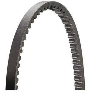

Here's a little trick that might help. Many fan belts have part numbers that relate to their size (see example below). The "15" relates to the width/style of the belt & the "470" = 47.0" length, so this is a 47" long belt. (another example, a #15385 belt would be the same width/style as this belt, but only 38.5" long)
belt part # 15470
