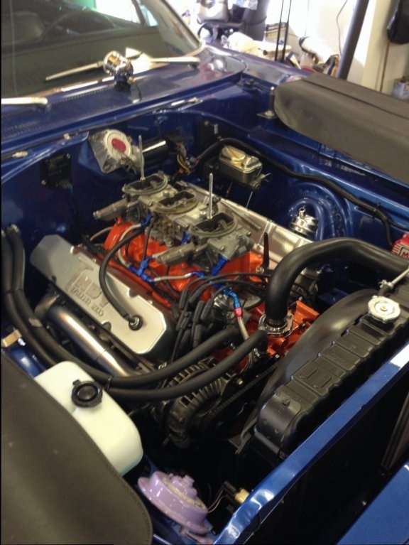

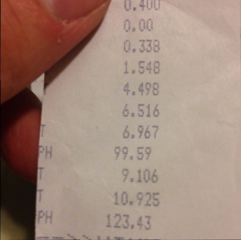

Unfortunately you will never convince the big cubes builders of this. Those of us that build of more than 1320 ft its a no-brainer as high torque and low rpms with low gears go not get you down the road very fast or vary far between fuel stops.
my standard port window 511 with a six pack in a 4000# race weight combo runs like a raped ape, shift at 62-6300 and trap a bit over 6500. That's running through mufflers the way I drive it to the track. It's all about the right combo, the small high hp motors really work well in light cars. The big heavy cars really need the torque to get em motivated. I'm sure there is more in my combo if I wanted to start throwing torque converors, intakes, open exhaust, and even suspension (mine is all stock) at it. I think an engine than can turn a 10 sec quarter in a heavy car and not be killing itself with rpm is a plus. I'm pretty confident if I switched all my parts over to a 470 short block with the same compression, the road chickens et would suffer a small amount (even if I did turn it harder) After all, I had all the same parts on a 446 and the best et I seen was 11.58.

It's funny you said your 446ci ran 11.5's and your current 511ci engine runs 10.9's. It's really proportional to my initial bench test theory, you probably make 50-70 ft/lbs more torque from peak-to-peak in comparison to your 446 (5000-6500 RPM) right?
I understand what my man is trying to say but its just bench racing and I was just poking at him. 470s rule I'll stop my 512 build and do it all over lol
What are you saying?? Lol. whats funny? It does exactly what I expected it to do, i didn't just guess at parts. I've been at this for a bit.. it's a big torque monster for the street. I built a combination for an intended application. According to what I'm getting out of your theory the motor should be all done by 5500 rpm with standard port window. Is that the case? Using the McFarland formula?
