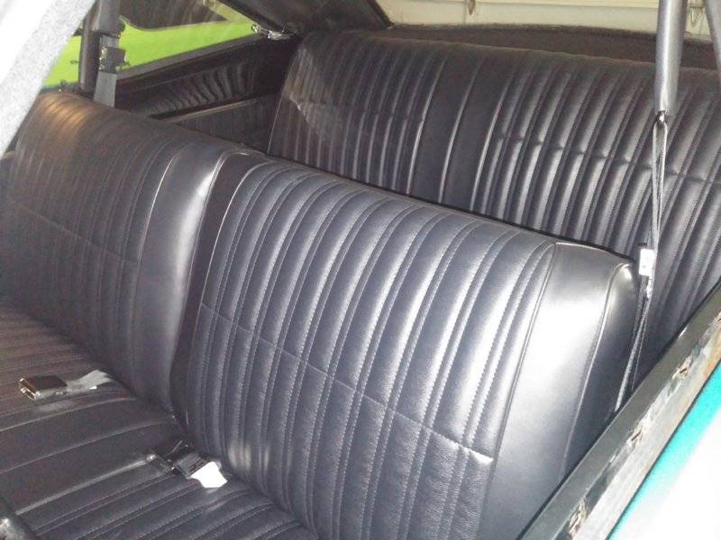

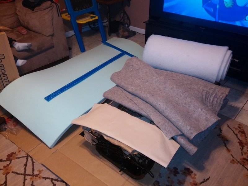

I used the install kit from legendary, plus a layer of some thin high density pink cushion stuff from my local upholstery shop. My seats are comfy !

I never cared to measure. I used what legendary gave me plus 1 layer of that thin pink material. I'd say that stuff was maybe 1/2" at most, but compressed very easily.
