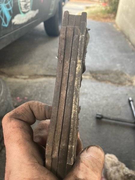

so far i found a bent strut rod on the drivers side and the driver side caliper is dragging and it seems like the spindle or caliper bracket is bent, the brake pads wear unevenly, see pic.

That type of wear tells you, Caliper is not squared with rotation of the rotor, there could be dirt/rust at mounting or loose - if spindle is bent it could cause the same issue, both would cause brakes to drag and pull steering to that side - strut rod will not cause this problem ! Any hardware holding Caliper to spindle will obviously need to be checked, any worn or defective parts mounting that Caliper will let it move under braking and as soon as the Caliper is crooked - the pads will wear offset, grab rotor tighter, create more heat ..... now your steering is pulling . I don't know what type/brand but I would take it all off and closely inspect everything - best wrenching to you

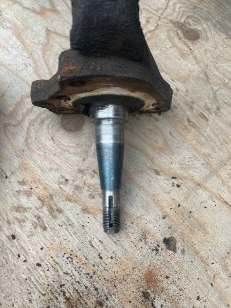

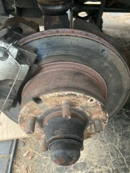

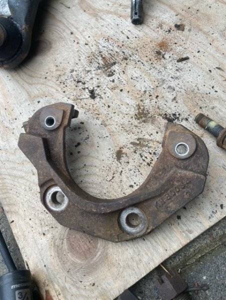

update: took it apart today, pics below, does anyone know if this after market or from a donor car? looks like a donor to me, it's heavy
should i try to stay with this setup style or get a new kit? thoughts?
