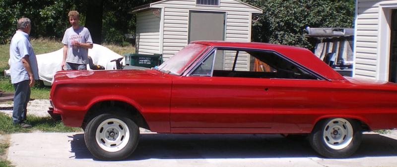

my son and I are about ready to fire up his 67 gtx clone, we have a 650 carb to start it up, but if all goes well, we know we will need to feed it a little better. we think its about 12.5 to 1 compression, will have to mix in some race fuel. thanks....Bob IMGP0068.jpgIMGP0027.jpg
