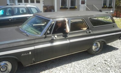

Anyway, I'm sick of playing with the stock points distributor on my wifes 65 Belvedere wagon stock 273 2bbl auto. Which electronic conversion kit is good? I see some new names out there. It's just a stock cruiser. I think the old distributor is just getting worn. Thank you all.
