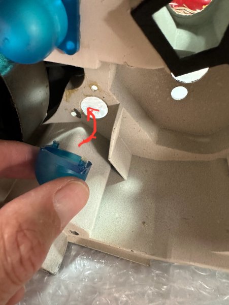

What would be the best glue or epoxy to adhere this plastic bulb casing to the aluminum housing on a Rallye dash? This is on a 69 Bee.
The company that restored it evidently didn’t use what was needed to create a good bond, two of them have come loose.
TIA
Either Jb Weld Clear 5-minute epoxy or the tried-and-true Jb weld Og that cures overnight. I have used both with great results.
the one above looks like it has clear adhesive squishing out. I would scuff both sides and stick it together with epoxy.
Original jb weld if it's not going to be visible. I've been using clear weld recently and it doesn't seem to harden if it has any thickness to it or have the adhesion qualities of the grey stuff. It would probably be fine though for something light weight like that.

I personally like Gorilla glue
Is there enough plastic "stud" left to melt it into a shop head like was originally done? Otherwise my "go to" these days is Gorilla 10 second Super Glue.
Yeah prob not. I’ll double check tho.
Alum to plastic is a tough nut to crack, mainly because the expansion rates are so different, and a hot dash says it all.
So look for an adhesive that remains slightly flexible, as I doubt there are any structural concerns here.

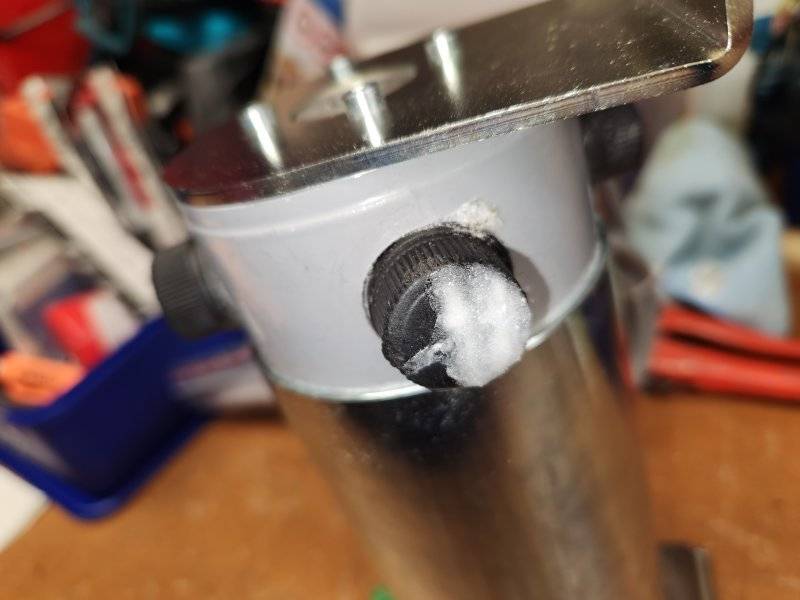

I have tried that hack using Super Glue and a sprinkling of Baking powder....it works well.
I have used it on several different materials....including a toilet waste pipe that I accidentally drilled into....lol
That stuff sets nice and hard and stays strong for a long time. :thumbsup:
I also used that method on a brush cap for a 60-Volt DC motor - Bakelite plastic material....set in seconds. I just applied several coats, and it was done. This was on a commercial paint vibrator machine....so it would have clapped out by now if it wasn't up to the task.
There was enough to melt it. Did that and it worked great. Got the Gorilla glue as a stand by but did not use it. I have another that fell off but have to remove the board to get to it. I am going to do this to all of them in place as I do not trust the glue they used now.
