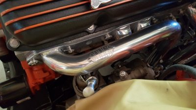

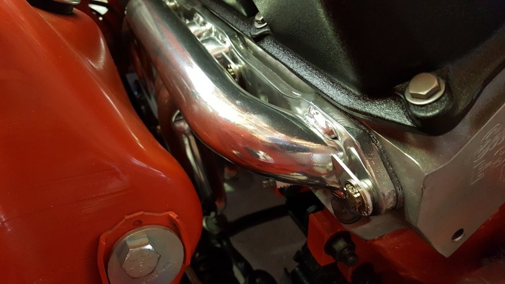

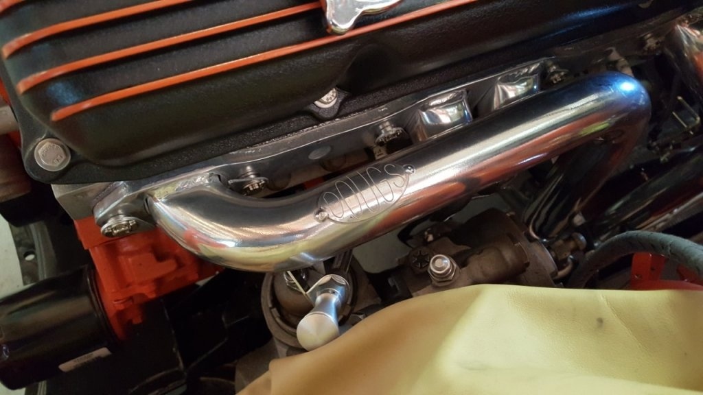

Debated between Doug's and TTi. Both make an AWESOME fitting header. I finally went with Doug's ceramic coated 1 7/8", Remflex exhaust gaskets, and Stage 8 locking fasteners. Doug's fit like a glove, even with power steering, no issues. IMOP, don't waste time and money on Hookers
