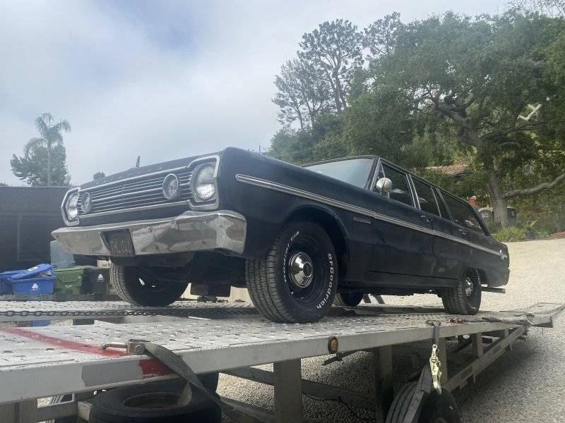

I’d like to drop the front a little bit I just cringe looking at it even at the height it’s at now…
Any preference on hemi pan/windage tray? Thanks

That looks like the full deep milodon pan. The semi-triangular low-profile pan doesn't hang nearly that low, and still holds seven quarts.
Milodon 6qt (hemi?) pan,30761, is 5" deep, the one I'm using, 30930 is 7", yours looks like 31010, 7.75 deep.

I wouldn't lower that any at all with that pan on it. The 6 quart pan would be plenty enough oil unless you're turning nearly 7k rpm with a high volume pump....

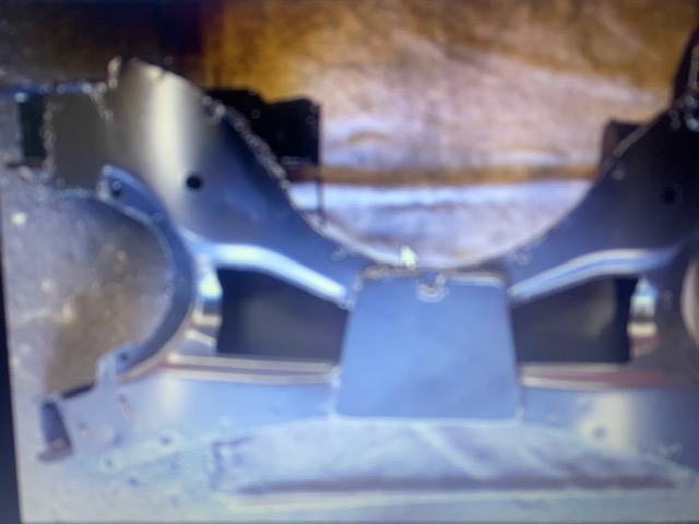

Got welding skills? Use a Hemi pan & add something like this...
If you’ve been running around with your pan hanging that low, the hemi pan will give you considerably more clearance even after you lower the front end and will satisfy your engines oil needs
Actually I bought it this way not too long ago and every time I do drive around it’s always on my mind..
