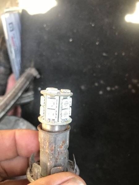

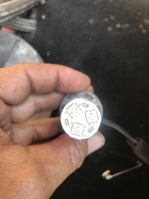

I found the same issue and found low voltage at the sockets. Traced it up to the connection at the kick panel and found the same low voltage. Fuse block same thing. Have pulled the bulkhead connector apart yet but that's the next check.
No part number just an 1157 in red.
