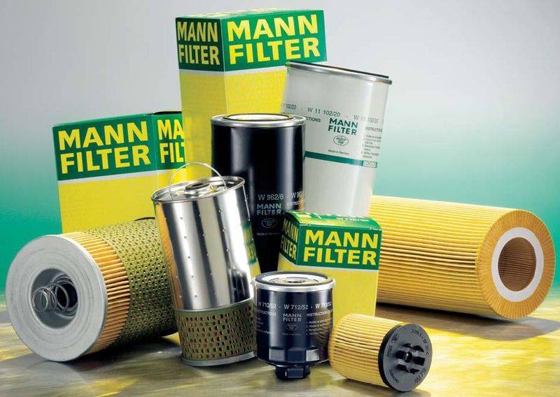

Mann+Hummel filters are fine with me too.
Mann+Hummel is the company that owns WIX.
