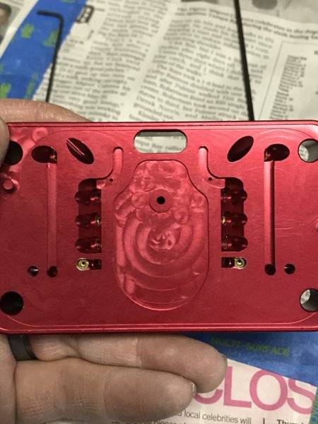

There expensive little buggers, buy a bag of blanks and drill them yourself. You can usually find them on eBay. Just need a good numbered drill set.
I use 6-32 set screws ( drill to suit) and move them to the lower position like most of the original holley’s. You just need a 6-32 bottoming tap. Pretty easy conversion. “Suppose” to help the idle quality. IMO it has on the carbs I’ve converted so I just automatically do it now. You can also buy the set screws in bulk.
View attachment 619907 View attachment 619908 View attachment 619909
Curious as to what kind of change in idle air/fuel readings you are experiencing with a 1 number change in ifr size?
Kinda depends on how close you are, I normally move atleast 2 sizes. You going down? What’s your current setup?
The car runs and idles great with no soot in the tailpipes, but the idle A/F mixture was 12. I messed around going up 6 sizes on the idle air bleeds first. That helped somewhat as far as A/F, but the car ran like crap everywhere else. So I dropped back down 5 sizes to I believe to 71's. Came stock with 31 ifr's. From the reading I have done, everyone stated that a one size change there will make a 7% difference. Holley told me to go with 30's, so I did. I am now up to 12.6-12.7 at idle. Would have been more, but after that change I had to open my idle mixture screws from 7/8 to 1 turn out.
Ideally they idle best around 13.5 range in neutral if timing and everything is correct. Not sure what kind of carb it is but you may need to add transfer slot restrictors to clean up the off idle cruise. I’d say you're close on the IAB. Try a .028-.029IFR. Shouldn’t need to go any smaller than that. TSR would be my next move after the IAB.

Yes, it’s a balancing game. Smaller you go the more you have to open the screws up. Remember those ifr’s Are feeding fuel to the transfer slots as well as your idle screws. That’s were it sometimes helps to start limiting what the transfer slot can pull if you get to a point where your idle screws are good. I’d bet if you lower the ifr that would help you out (position wise). Could be some of the reason it wants more fuel to behave. How much transfer slot is showing pri & sec?
