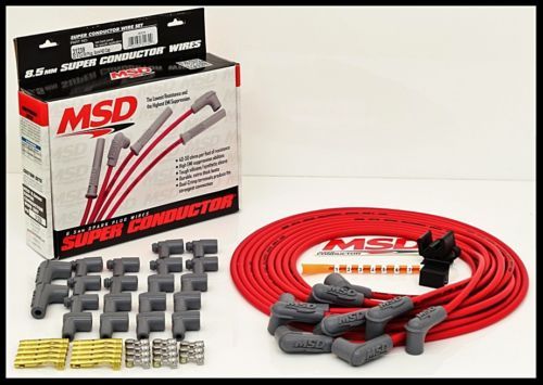

I'm running MSD - the ones I bought are straight, but bend a bit to your needs. Got them off SummitRacing
That wire set has pre molded spark plug ends, which are straight. .its the distributor end that you terminate. If all straight spark plug boots would work, this would be a nice idea. But, they don"t.
www.msdperformance.com/products/spark_plug_wires/universal_super_conductor_wire_sets/parts/31193
pre made wire's never lay out the way I want them. make your own up its easy kit comes with crimping tool. all you need is a vise and a razor blade they come in black or red
That wire set has pre made spark plug ends, which are straight. its the distributor end that you terminate. If all straight spark plug boots would work, this would be a nice idea. But, they don"t.
Those straight boots are multi angle.They bend to about 70 degrees with ease. If you need 90's just slip the wire out of the (multi angle boot) and push it through the 90 with a little WD-40 or Silicone spray and re crimp the new plug end, kits come with extra terminals and choice of cap style ends,HEI or socket style for the distributor cap. if you need more 90's there at your local speed shop or online.if you need mostly 90's get the kit with all 90's and buy a couple of straight (multi angle boots). good luck
