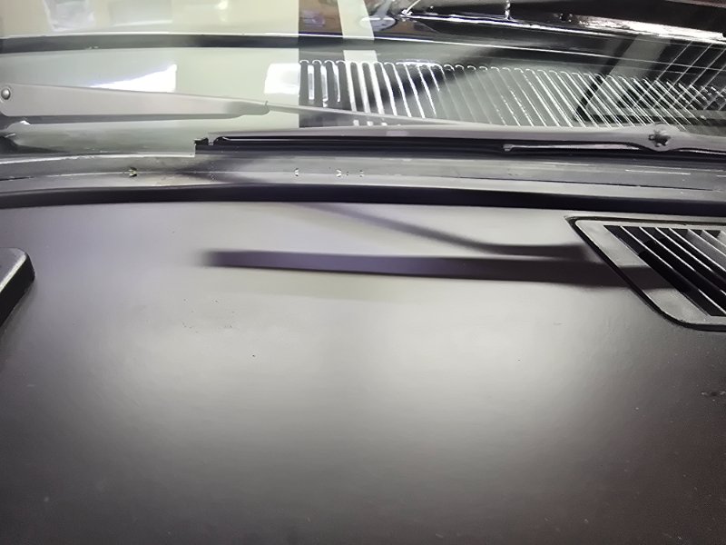

If memory serves me correctly, you are correct about the pieces that get the suede paint. I got mine from Kolor Korrect and couldn’t be happier with the results.

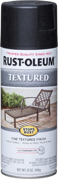

Rustoleum is not good. Not lacquer, not enamel, won't play well with other paints.
PPG makes quality paint that lasts. Two part with a catalyst, rattle cans cannot compete with that.
I agree, I have seen on here people saying how great the Rustoleum comes out, but every time I use it (in general) I am disappointed with the durability.

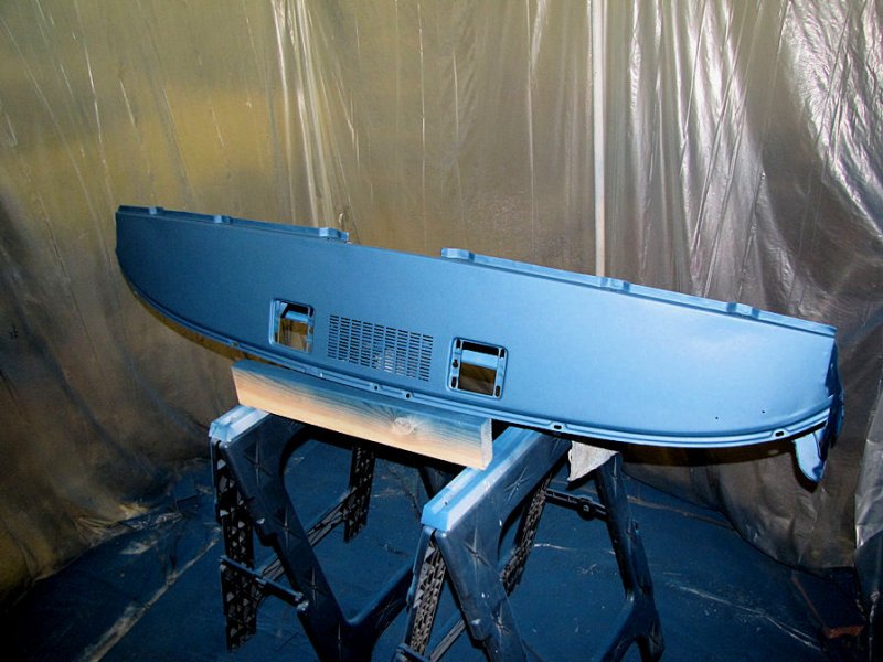

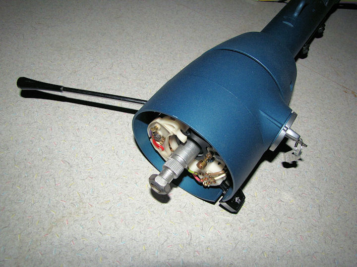

Went the Inst Specialties route for B7 suede. Good stuff.
Question for the rustoleum users: For the dash application, are you applying it to bare metal or to primer?
From past failures of virgin parts, the OE suede appears to be lacquer applied direct to metal without primer.
On a similar part (exterior part) I had pretty good luck with Rustoleum Textured Metallic paint, but partially because
the part was chromed I used an epoxy primer to try to help adhesion and hopefully a little longer life. So far it is OK.
