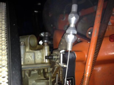

Ya know, I had a similar situation. The springs they sell are junk and that set screw kept falling off the base of my Holley 750 as well. I reused stock type springs (with the OEM spring bracket) and turned that set screw backwards. The screw head was just big enough to catch the carb base nice and solid. I may have used a screw with a slightly larger head, I can't quite recall.
Yeah I've put a spring on from another set I didn't use but I hadn't gotten around to sorting out the screw. I'll give your idea a burl. Thanks mate!
