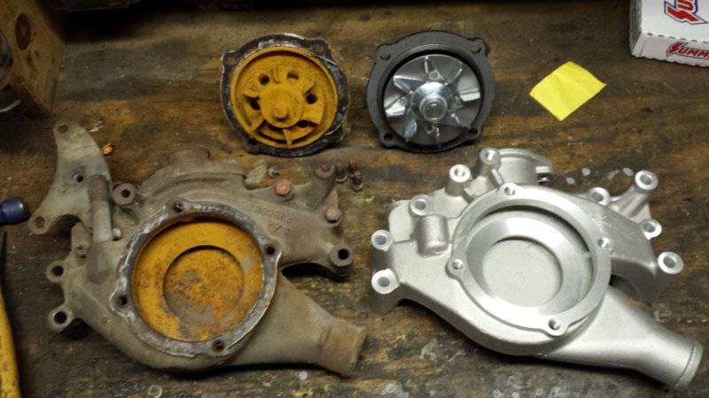

Looking for recommendations on the best water pump for 440
Considering aluminum housing and pump. Car will be using vintage air system
Any manufacture recommendations would be appreciated
Somebody post a link to the big water pump thread, please.
If I recall correctly (IIRC) the stock housing is the best due to issues the aftermarket ones have.
Don’t get the 440 source one. They had a history of partial passage blockages. I’ve got the aftermarket aluminum housing from Mancini Racing and it works great. You want the pump with 6 fin blade Milodon HV impeller (also from Mancini or Bouchillon).
here’s one of many
https://www.forbbodiesonly.com/moparforum/threads/water-pump-****.81077/
Be aware that greater number of fins generally equates to faster coolant flow which actually does not always equal better cooling. The 6 fin pump setup works well because it gives the coolant more time in the radiator so heat can be drawn out. If you look at stock big block pumps specified by Chrysler that is why the big block pumps had the lower fin count.
Ditto on the FlowKooler. Have had one on my Charger, 383 for 3 years now. Very happy with it.
here’s one of many
Thank you for the information
Time in the radiator is key I can see why a six versus an eight could produce better cooling
