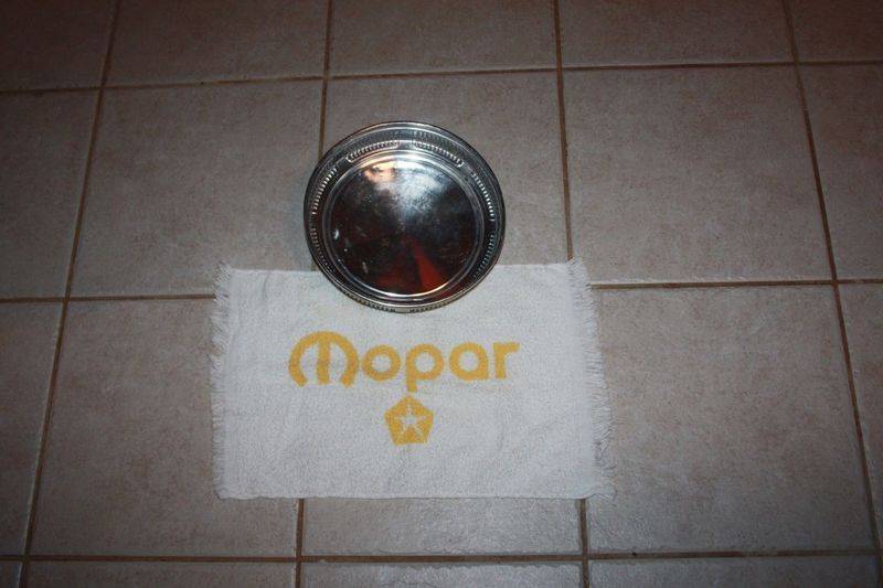

I've got a set of 70 Plymouth "dog dish" hub caps I'd like to install. The paint is mostly gone, but I can tell that they were painted black inside the "PLYMOUTH" lettering + inside the "grooves" around the edge. What's the easiest way to repaint these & what type of paint do you recommend? THANK YOU!

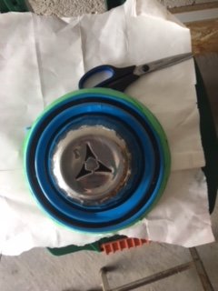

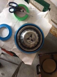

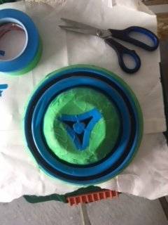

I masked the letters with 1/16” tape.

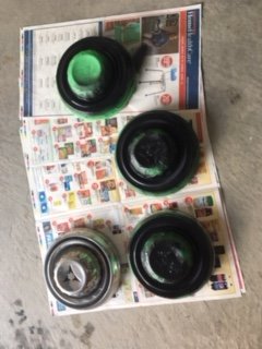

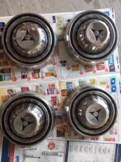

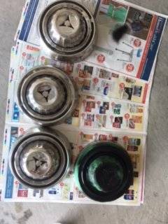

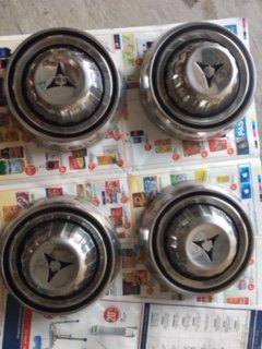

The best and easiest way is to this. Take a picture of the cap, wipe it down with acetone to get rid of dirt, paint etc., polish the cap, wipe again with acetone. Now here’s the fun/tedious part. Go to your local hobby store and get the Testors model paint in gloss black enamel along with a **** load of the model “sponge paint sticks”. Dip the sponge head into your paint and then paint the areas that require it. The paint will “flow” off the sponge tip and will look like crap if you don’t get enough paint to start with. Don’t worry about masking off anything, when you done, take a q-tip dipped in acetone, shake it, now go around any areas that got paint outside of where it should be.
I cleaned mine with baking soda , then dishsoap and finaly acetone . Let them dry overnight .
I taped them with a tape a friend gave me that bends its from Automotive assembly plants used for tight paint lines .
I think 3M makes it , I can take pictures of the roll and if you really need it I'll send you a roll .
