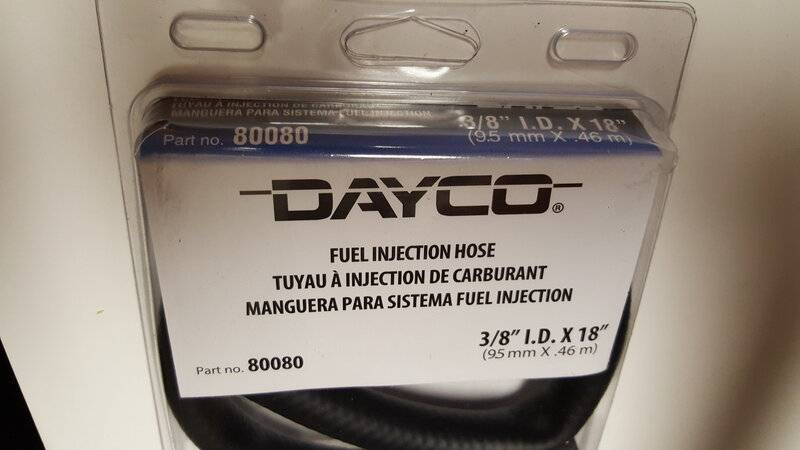

I used fuel injection hose for the short connections . Ethanol capable. This is the 3/8". There's the 5/16" also.
