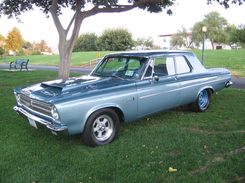

Right now I'm running 275-60-15 on my 63 Belvedere.
No clearance problems at all.BUT I am using 15x7 with a 4 1/4'' backspace.
You may have tight upper/outer wheel house clearance. Also depends where your rear height is set.

Same tires were on my 65 Belvedere.
I can only tell what I've got.
I THINK I have a 65 8 3/4 under my 62. I have 255/70x15s on 15x8 Mopar steelies, with 4"backspace, cause the 275x70s I wanted to run would have rubbed the fender.
I also have 28x10.5 slicks on 15x8 1/2 with 4 7/8 bs that have .300 spacers to work.
If I were you, I'd try to use 4.5 backspace. If you are stuck on 4"bs, I would probably go with the smaller tire.
(My slick is basically the same as a 295/55x15.)
